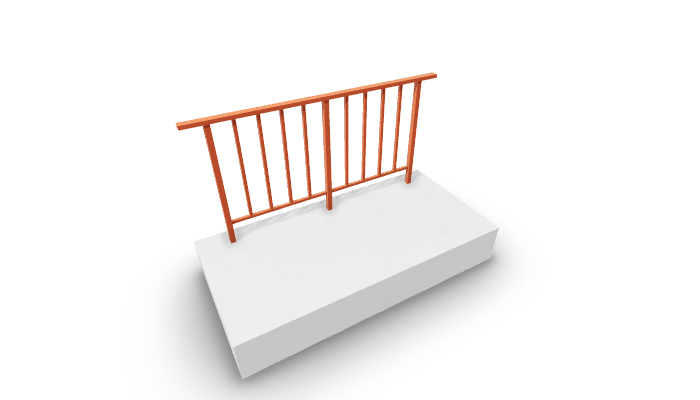

I’m working on a side project that currently takes the preview images from a version/commit, passes the image into dalle as a ImageEditRequest along with the commit message as the prompt. Dalle has an optional parameter for passing in a image mask as a way to tell la computadora what part of the image to apply the prompt to. It would be great to experiment with a material id rendering down the road, but for now I’m keeping it simple.
For reference, here are a couple of tests I’ve done so far without masks. I’m focusing on using versions/commits at the moment since I like the idea of having commit messages influencing the output.
The preview from speckle
prompt 1
prompt 2
prompt 3
