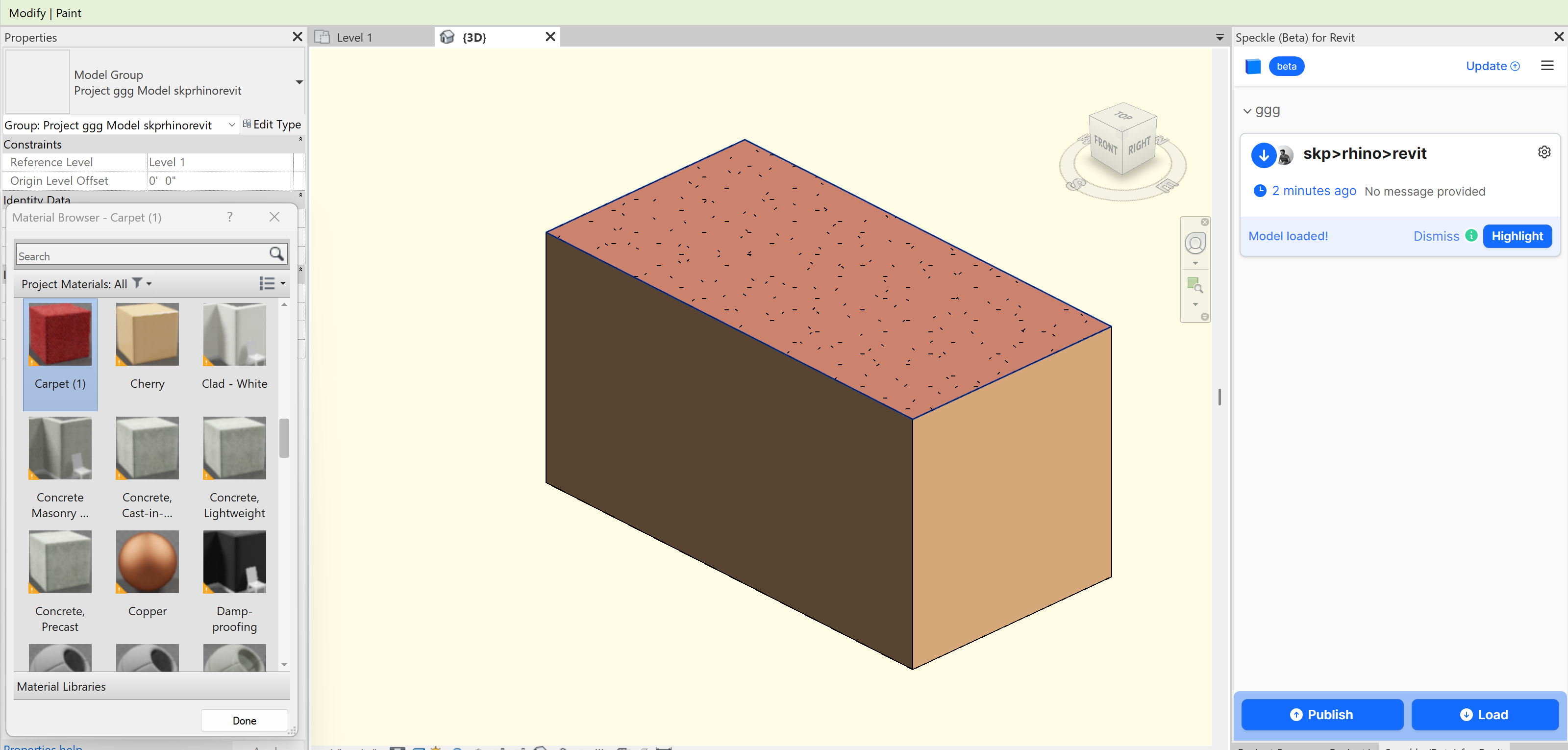

There is a way, but it is a roundtripping by using Rhino in between.
There are some facts that how applications deal with the geometries :point_down:
  • SketchUp is not capable of handling Breps because there is no concept in Sketchup API, that’s why we just extract them as meshes.
  • You can receive your Sketchup model in Rhino and run MeshToNURB command which converts meshes to Breps. It is a beauty of Rhino and Speckle because we do handle Breps nicely to make them useful when they are received in Revit.
  • Then you can receive the model in Revit and paint it as in image.
This is the only advice/hack that I can give you.
Hope this helps
