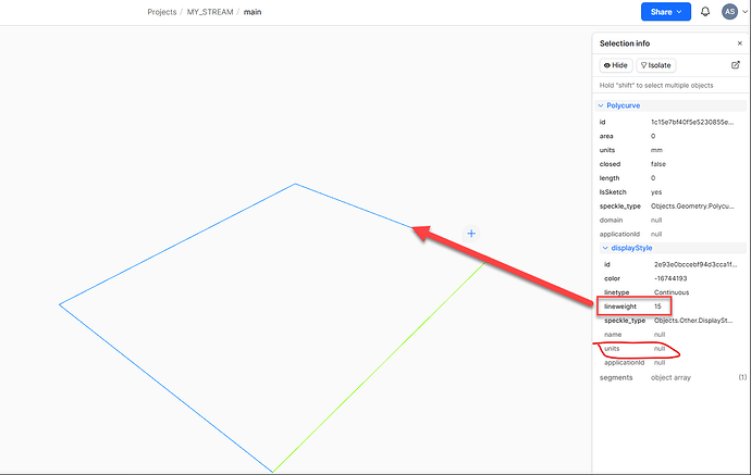

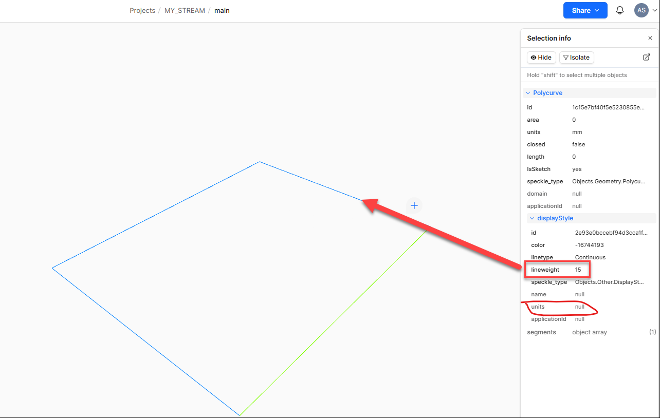

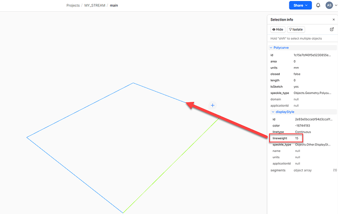

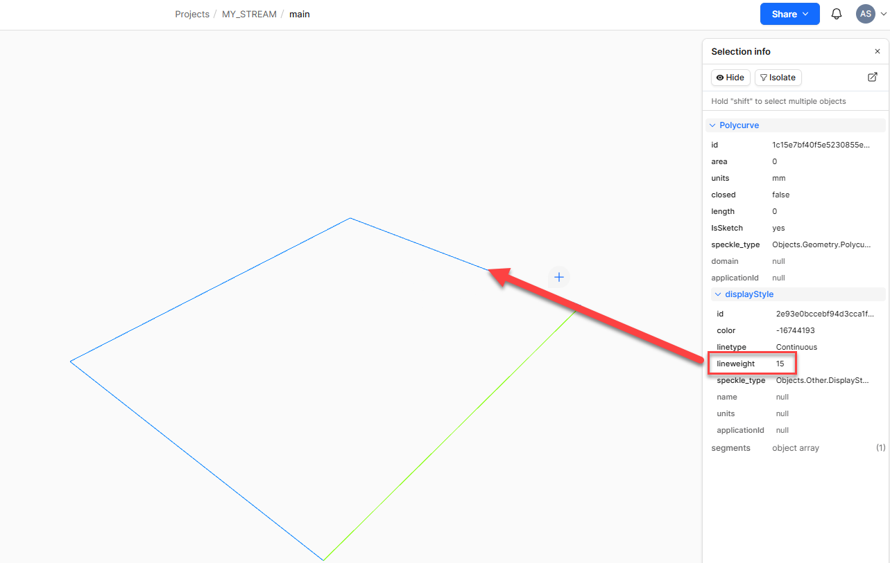

I have sent lines objects held by a polycurve.
each line has a color, linetype and width passed through DisplayStyle.
Unfortunately, lineweight is correct in data but can’t be displayed correctly.
See snap : blue lines have a big lineweight compared to green one.
How can I resolve this?

For the line weight to be considered, you need to specify the units. null for units makes the viewer ignore the lineWidth
