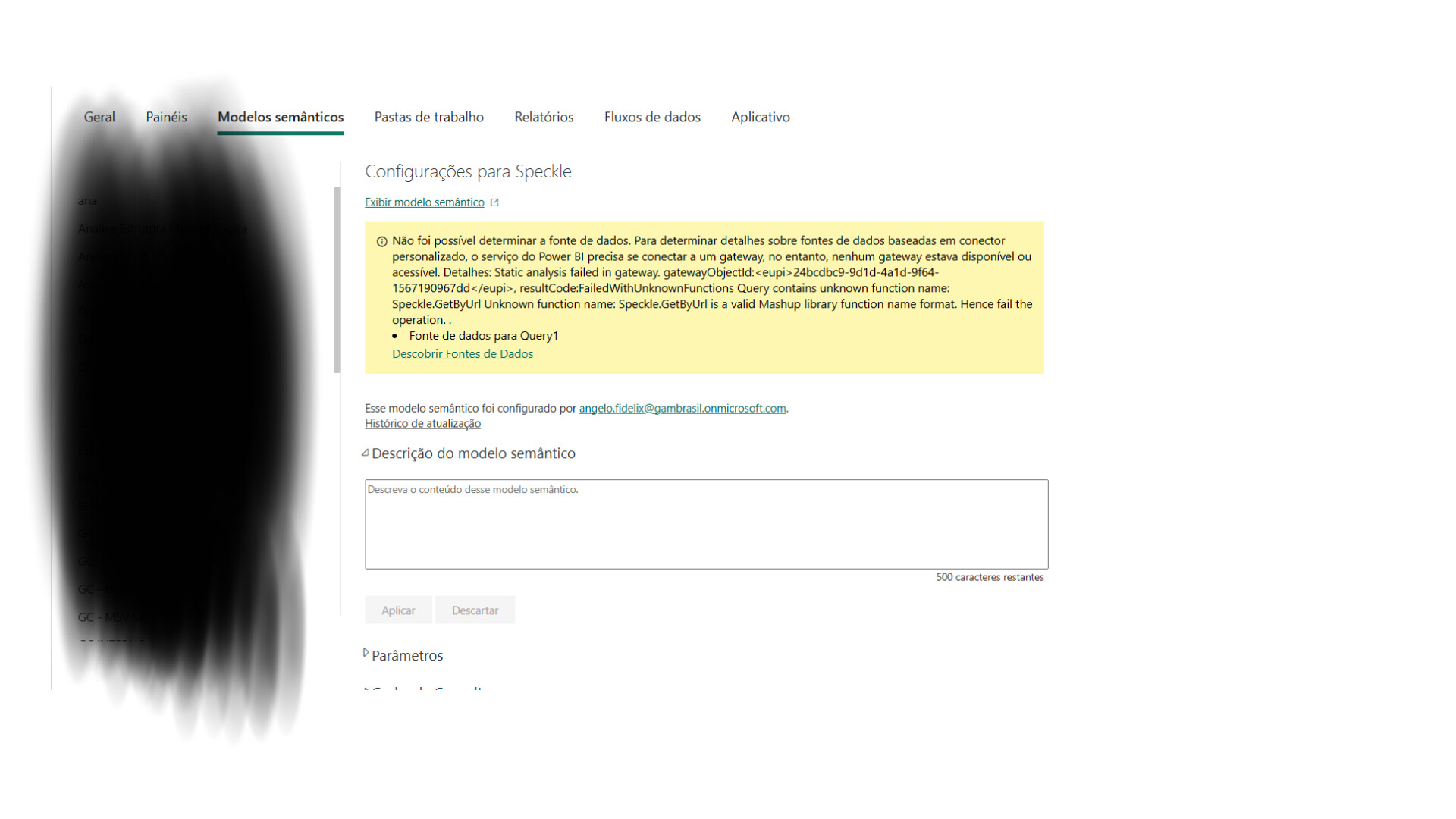

When I publish my Power BI dashboard to the web through my Microsoft Power BI account, it fails to refresh due to a table that uses the Speckle model. The error shown is a Gateway error. However, since the Speckle model is accessed via a URL, I would expect the refresh behavior to be similar to that of a Google Sheets connection—where only credential configuration (like logging into a Google account) is required.
Below is the error message I receive:
“The data source could not be determined. To retrieve details about data sources based on a custom connector, the Power BI service must connect through a gateway, but no gateway was available or accessible. Details: Static analysis failed in gateway. gatewayObjectId:24bcdbc9-9d1d-4a1d-9f64-1567190967dd, resultCode:FailedWithUnknownFunctions. Query contains unknown function name: Speckle.GetByUrl. Unknown function name: Speckle.GetByUrl is a valid Mashup library function name format. Hence fail the operation.
Data source for Query1.”
Hey @Angelo_Fidelix ,
Sorry to hear you are having trouble publishing your report. Have you tried setting up a data gateway: Use custom data connectors with the on-premises data gateway - Power BI | Microsoft Learn
