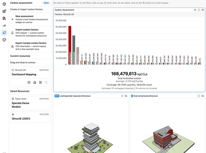

Custom carbon factor datasets are now supported
Custom carbon factor datasets are now supported in a beta form as a standalone Carbon Assessment
You can now:
  • Upload your own datasets
  • Map to your model classifications
  • Store per workspace or project
  • Switch between default and custom datasets for comparison
This was driven directly by requests from teams working with regional datasets, internal benchmarks, and other workflows.

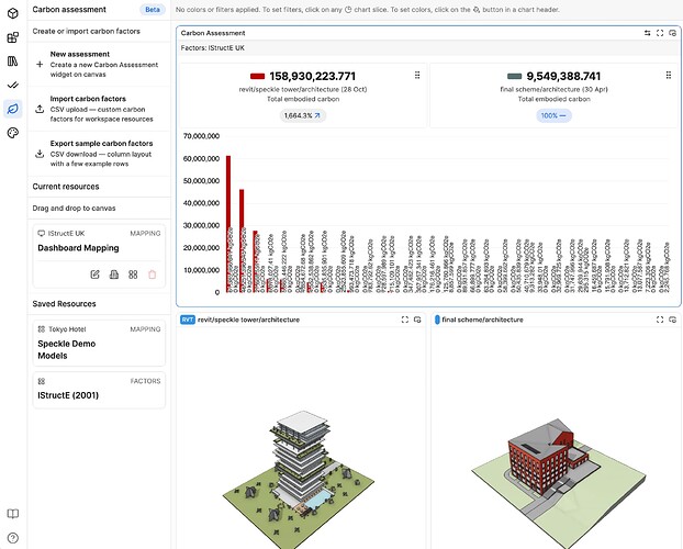

We have also added the ability to compare two models

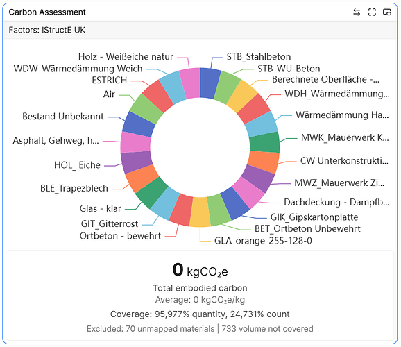

Any ideas on why the calculation won’t work? I’ve tried different factor systems and mappings, but the sum always stays at zero. I suspect it’s something to do with model units…?

@jonathon I just had a brainwave. So I started Revit up again, this time the localized english version, and exported the same model with the same export settings as a new version. And tadaaaa, suddenly it works:
So this seems to be a localization issue indeed.
