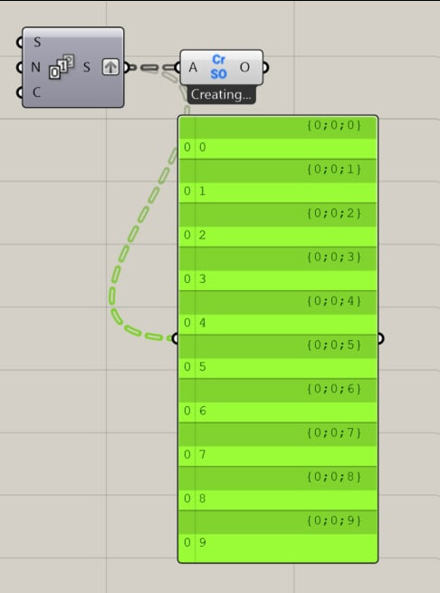

Trying to create more than one Base object with grasshopper, I noticed that the component works well with a list but it actually do nothing if the input is a tree.

Here how I can reproduce it:
  1. Place CreateSpeckleObject component
  2. Add Input parameter
  3. Connect a Series (Graphted): It works!
  4. Flatten the Series output, remove the flatten, graph again
  5. Disconnect the input cable
  6. Riconnect: Broken
Simplify doesn’t work for me.
Thanks for the detailed description! I can reproduce the issue with these steps, seems to be some sort of problem with how it’s handling component iterations internally.
I’m already looking at a potential fix so I’ll keep you posted.
