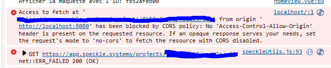

I have the same problem (CORS)
Here is my code :
Can you help me ?
Is it a problem with a CORS or with my code ?
