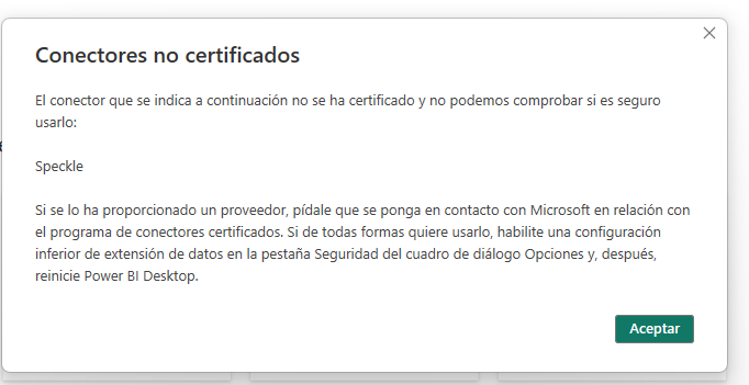

hola, no puedo instalar conectores de specke en power bi.
ya active desde la barra inferior derecho.

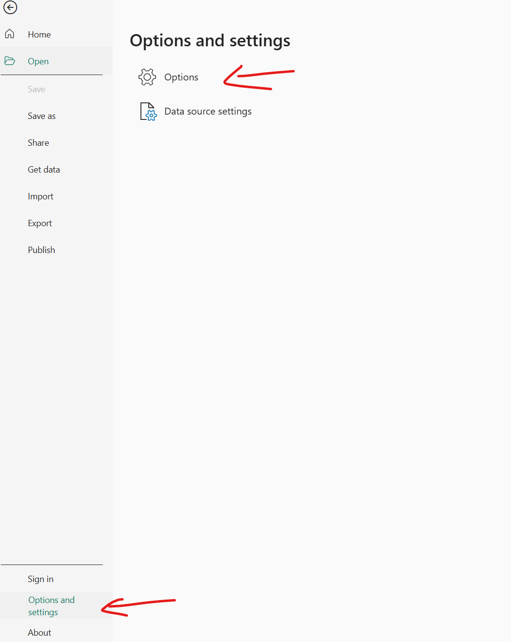

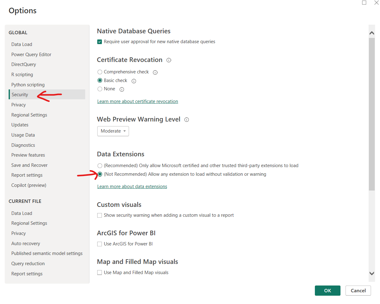

You need to go to Options and settings > Options > Security and change the data extension option. See images below.
!!!Note: After you complete these steps, restart Power BI. !!!
There is an alternative to this we recommend to IT teams.
you can write our connector fingerprints to HKEY_LOCAL_MACHINE\Software\Policies\Microsoft\Power BI Desktop
  • 5270B3C69218C25BE2F20AB2DD76429DDAA38F61
  • CDC489B709A709E3283568A9B75D75180B1355BE
These values needs to be appended to the existing value if it’s there (it’s a line separated list of fingerprints).
Microsoft has some docs on this also https://learn.microsoft.com/en-us/power-bi/connect-data/desktop-trusted-third-party-connectors .
This should mean you do not need to set the “Allow any extension to load without validation or warning” setting, and will not see any warnings about “Uncertified Connectors”.
I only recommend this option if you’re familiar with regedit and have your IT teams approval.
