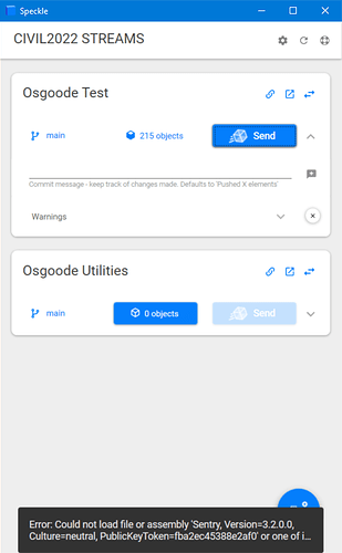

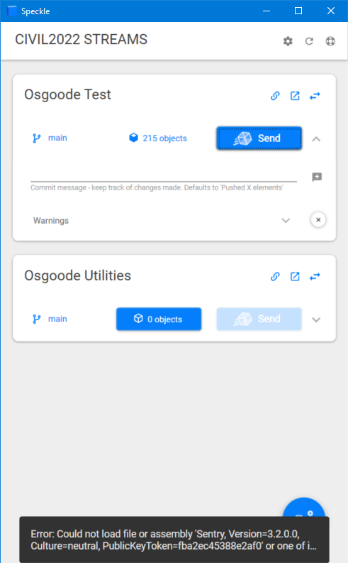

Could not load file or assembly ‘Sentry, Version=3.2.0.0, Culture=neutral, PublicKeyToken=fba2ec45388e2af0’ or one of its dependencies. The system cannot find the file specified.
at Objects.ObjectsKit.LoadConverter(String app)
at Speckle.ConnectorAutocadCivil.UI.ConnectorBindingsAutocad.d__26.MoveNext() in C:\Users\circleci\project\ConnectorAutocadCivil\ConnectorAutocadCivil\UI\ConnectorBindingsAutocadCivil.cs:line 0
— End of stack trace from previous location where exception was thrown —
at System.Runtime.ExceptionServices.ExceptionDispatchInfo.Throw()
at System.Runtime.CompilerServices.TaskAwaiter.HandleNonSuccessAndDebuggerNotification(Task task)
at Speckle.DesktopUI.Streams.StreamsRepository.d__2.MoveNext() in C:\Users\circleci\project\DesktopUI\DesktopUI\Streams\StreamsRepository.cs:line 22
I have this same error - is there a solution for it? I have installed the same versions as Alessandro above. I have reinstalled Speckle Manager and the connectors but still get the same error. Please help.
Please make sure all autodesk software are closed when installing it (ideally after a reboot, to make sure no background processes are not preventing a correct installation).
