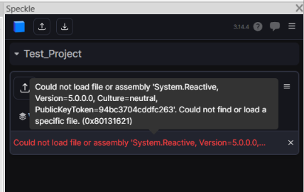

I am getting the following message on tryin gto publish a model on Revit 2026 -
I am guessing it’s a conflict with another plugin, but I’m hoping someone knows what this is!

Please could you share with me a Revit Journal file.
https://www.autodesk.com/support/technical/article/caas/sfdcarticles/sfdcarticles/Location-of-journal-files.html
This may contain some logs that will suggest which plugins may conflict.
This is the conflict entry in my logs
Jrn.RibbonEvent "Execute external command:CustomCtrl_%CustomCtrl_%Speckle%Speckle%Speckle for Revit:Speckle.Connectors.Revit.Plugin.SpeckleRevitCommand"
' 1:< API_ERROR { : Assembly version conflict in some references in Speckle.Connectors.Revit2026.dll assembly
'Addin's module RevitAPI of version 26.0.4.0 conflicts with same preloaded module of version 26.4.0.0
'Addin's module RevitAPIUI of version 26.0.4.0 conflicts with same preloaded module of version 26.4.0.0
'Addin's module Microsoft.Extensions.Logging.Abstractions of version 2.2.0.0 conflicts with same preloaded module of version 8.0.0.0
'Addin's module Microsoft.Extensions.DependencyInjection of version 8.0.0.0 conflicts with same preloaded module of version 9.0.0.0
'Addin's module Microsoft.Extensions.DependencyInjection.Abstractions of version 8.0.0.0 conflicts with same preloaded module of version 9.0.0.0
'Addin's module Microsoft.Web.WebView2.Wpf of version 1.0.1938.49 conflicts with same preloaded module of version 1.0.2478.35
'Addin's module Microsoft.Web.WebView2.Core of version 1.0.1938.49 conflicts with same preloaded module of version 1.0.2478.35 }

Any updtaes or reason this migh tbe happening? - Seems to me its not another plugin
Hey Avinash,
Do you have Data Exchange Connectors installed? We might have a conflict with them. To better understand this, we need a list of plugins you have installed.
We need to have access to whole journal file to have a better opinion.
We did some internal testing on disabling add-ins to find the culprit.
Turns out it isnt Data Exchange but rather D.TO plugin
Any known complaints before or reports of said conflict?
