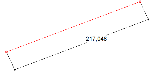

I have a subsidiary question. I need the double-click to show/hide dimensions of sketches. In TopSolid, dimensions are displayed as lines and a number. The sketch is sent to speckle as one object. So the normal lines (red on the screenshot) and the dimensions lines (black on the picture) are together in the same object, as different profiles of the sketch
My question is : does filtering.hideObjects also works on parts of an object? (it seems not) Or should we send to speckle the sketch and its dimensions separately as two objects?

Filtering works on a per-object basis so I would recommend you split the parts that you need to filter individually.
