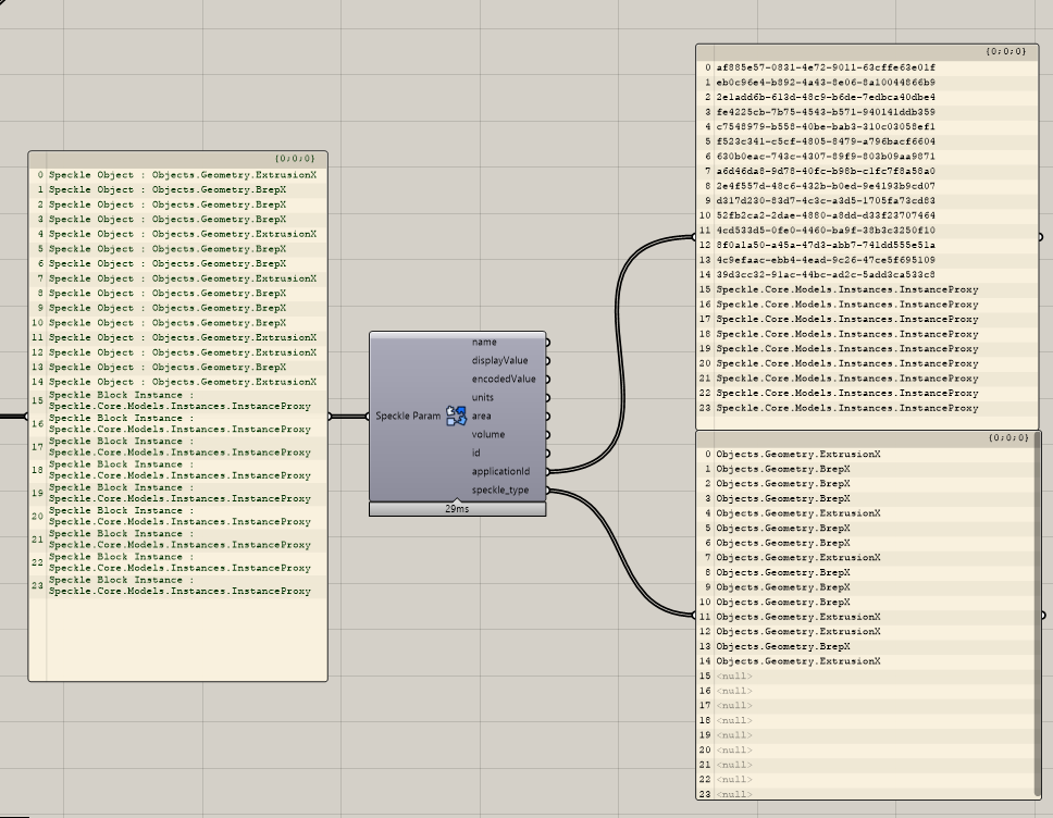

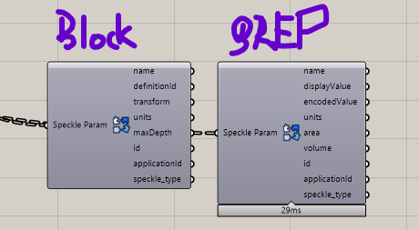

There seems to be a bug in the component when I deconstruct both breps and block instances together. The outputs become misaligned. I suspect this is because the outputs for deconstructing a block and a brep differs. I would think that the expected behaviour when both breps and blocks are deconstructed together, would be to show all the possible outputs and just have value for those that dont apply to that respective object
Yes we can make the adjustment - what are you using deconstruct for here? If there’s a specific field you’re looking for, I can look into adding that in the passthrough nodes (since deconstruct was originally intended as more of debugger/dev utility)
Mainly appId and id for doing diffing within my gh script
