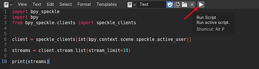

So here is the debugging steps:

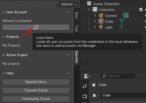

  1. Open Speckle Blender Connector and click refresh button.

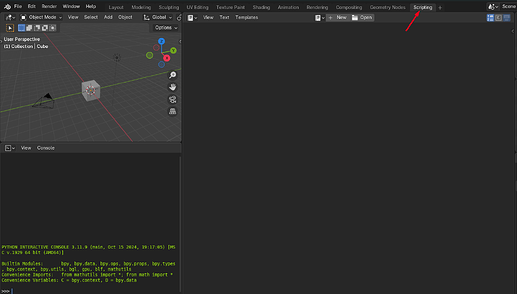

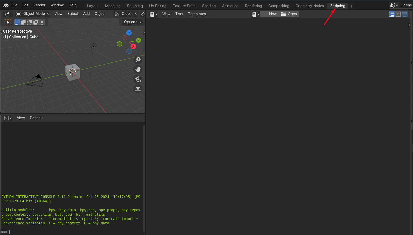

  1. Open Blender’s scripting window.

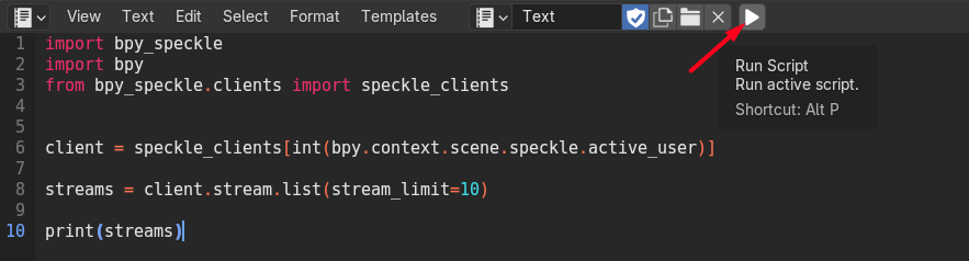

  1. Copy and paste the following code snippet and run the script.
import bpy_speckle
import bpy
from bpy_speckle.clients import speckle_clients
client = speckle_clients[int(bpy.context.scene.speckle.active_user)]
streams = client.stream.list(stream_limit=10)
print(streams)

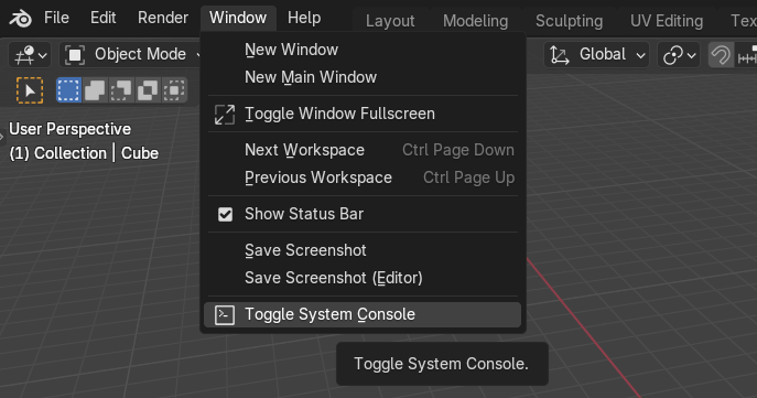

You should see the output in the integrated console. If not it should be in System Console.
In my case, this code is printing my streams. It could return an exception in your case, could you please send the output to us? So we can spot the problem :slight_smile:
