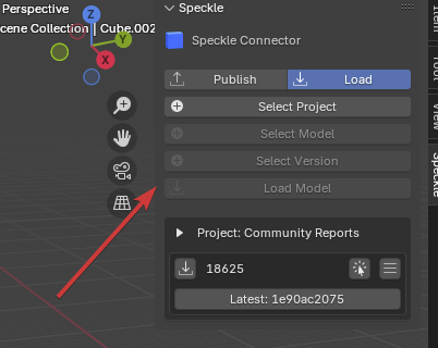

To not risk a second card I started download from the arrow symbol on this card - that worked.

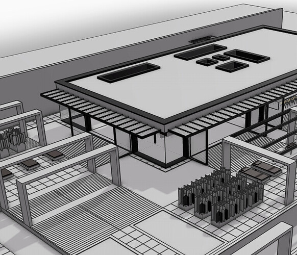

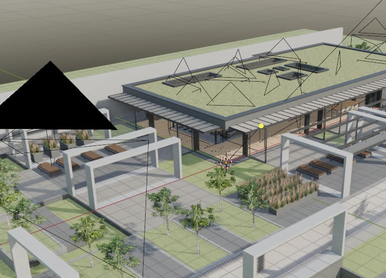

I have a File in Blender 1 :
I publish it to Speckle :

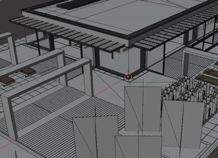

I load it from Speckle to Blender 2 :

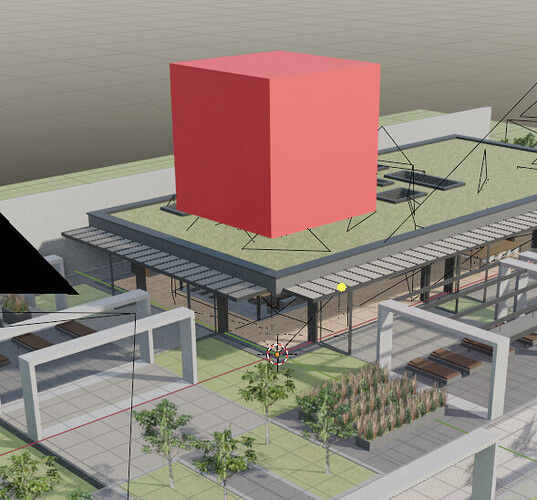

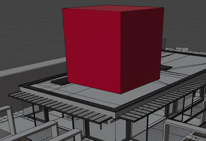

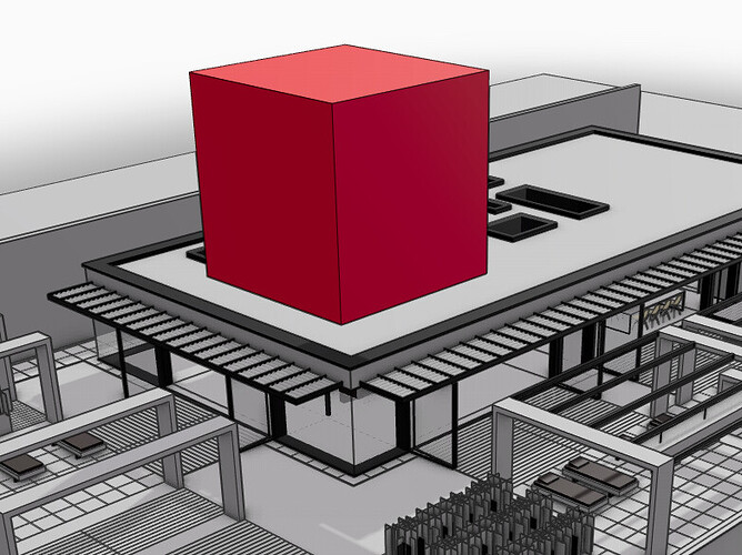

So now I go back to Blender 1 and update the File. I’ll add a red Cube :
I publish the updated Blend File to Speckle :

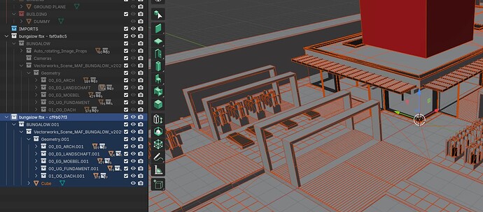

Now I want to collaborate and load updates into Blender 2, so I load the Speckle Model again (I tried all versions, deleting card or load from card, … same result) :

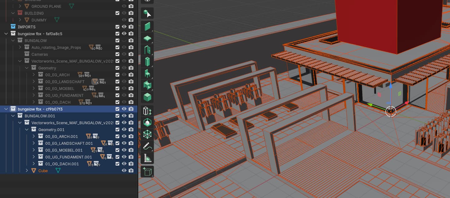

It looks ok at a first glance in View Window, but when I look in Blender’s Outliner, I realize, Speckle Connector has loaded the scene again ! I now have two sets of geometry in Blender !
2 Collections, both visible, overlaying in View Window :
Tis is the old one :
(newer Versions’s visibility deactivated)
And this is the Newest model Version :
(older Versions’s visibility deactivated)

@mikecrack Maybe you are loading/ the same model from this dialog?
This may result in duplicate collections.
Thanks!!! Yes it seems to be working fine now :heart:
