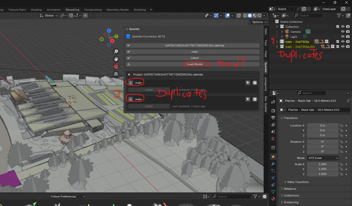

As already reported for the v2 in this topic : Revit to Blender - Creates Duplicates in Blender

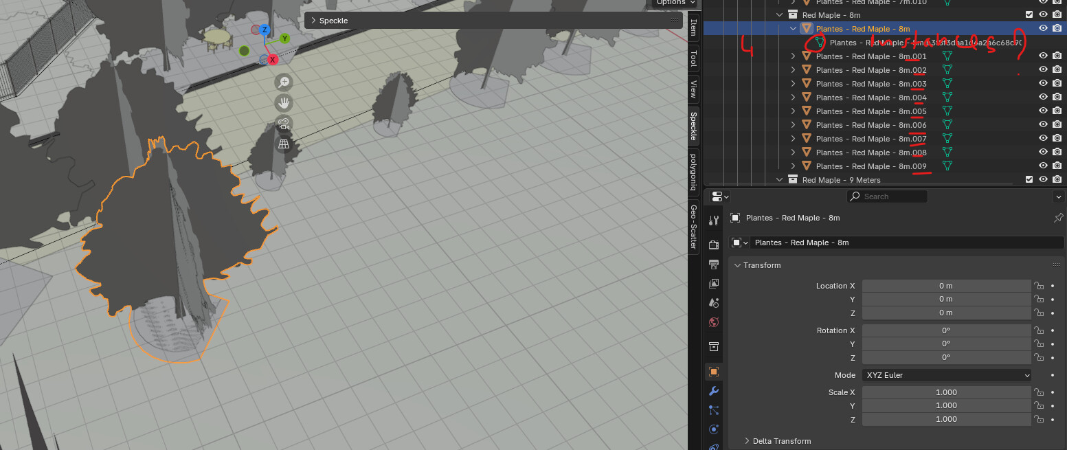

In blender we can’t send the model anymore to Speckle, and imported geometry gets duplicated and materials aren’t preserved. Also the instancing doesn’t work, objects are duplicated instead.
Please make the connector work as it was in the tutorial video
