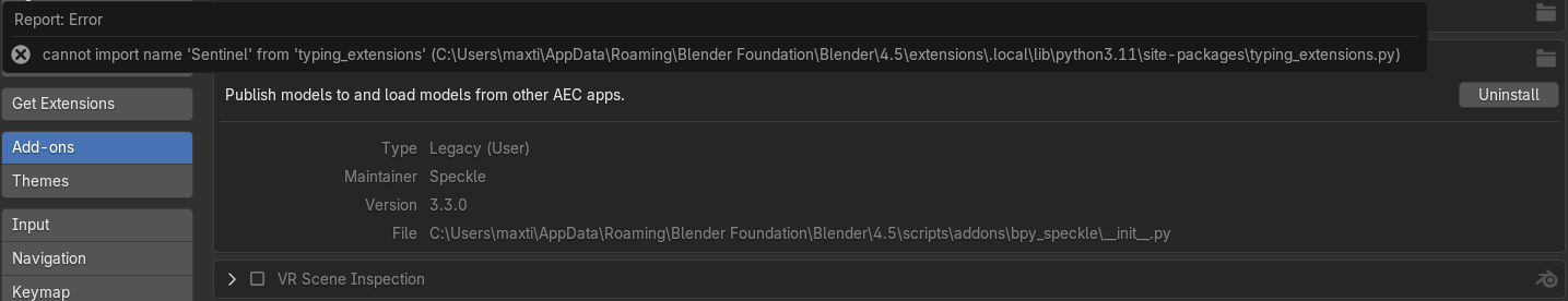

I failed to install Speckle in Blender 4.5. Any ideas how to solve this?
The error in the screenshot
“cannot import name ‘Sentinel’ from ‘typing_extensions’”
most likely implies there is a dependency conflict with another addon/extension you have installed.
I’d recommend disabling all other extensions except for Speckle and validate that the Speckle connector works on its own.
Then you can try enabling the others one by one. This should help you find which other addon the Speckle connector conflicts with.
If you still can’t run Speckle with other plugins disabled, you may need to fully uninstall them.
Once you’ve identified which plugin is conflicting, you may be able to find a newer/older version of said package that doesn’t conflict, but you’ll have to do some experimentation, or inspect the version of each conflicting dependency.
Thanks a lot, this solved the problem. For some reason it worked if I reloaded the plugins in some other order.
