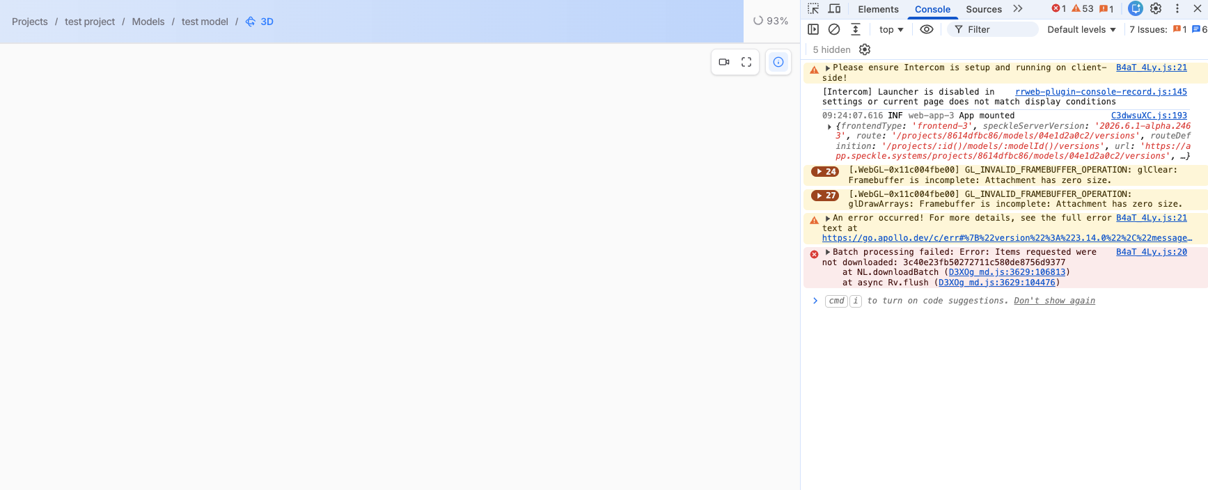

We use the serverDownloader.ts from the objectLoader2 package from the speckle-server repo. That is also the place where we added the local fix.
I suspect you are downloading it the same way on your webapp. i can repro it like this: upload a larger ifc model (does not happen with all large models). wait for ingestion to be done and then quickly open the version. it results in this:
