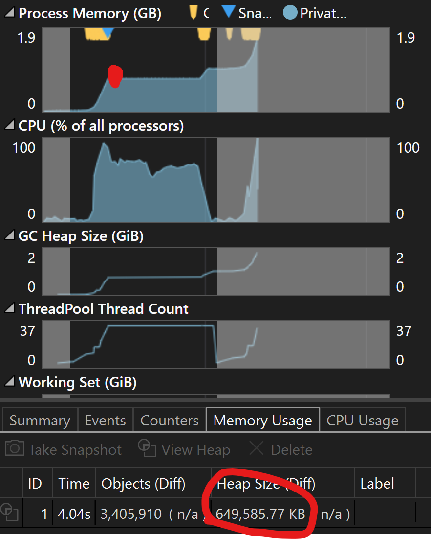

as a bit more info running locally memory is ~700MB after receiving the first model which seems to be where the error is getting thrown from the messages in the consol and ~2GB at the end of the run when other models have been received processed etc.
