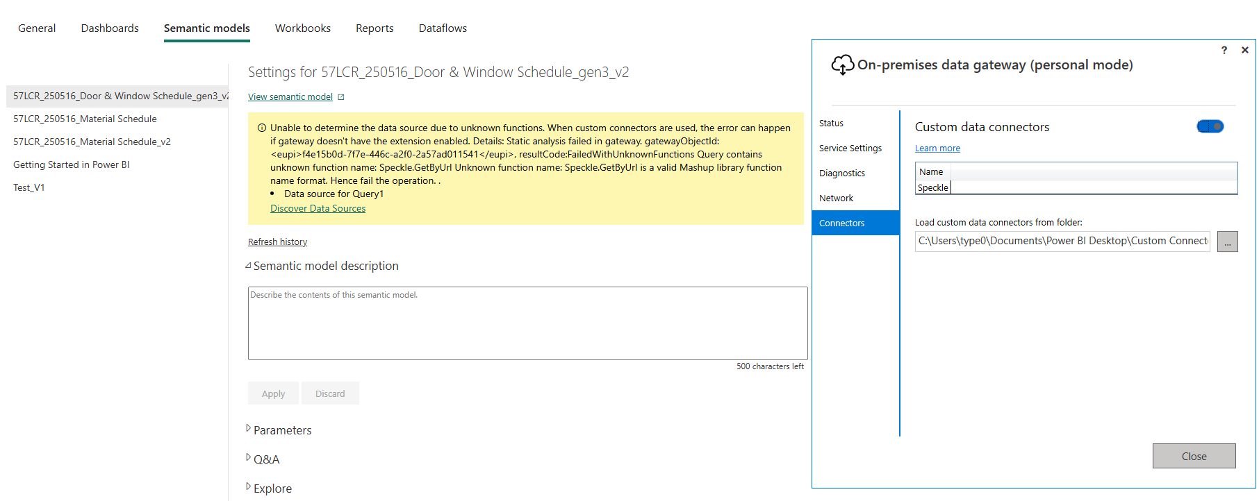

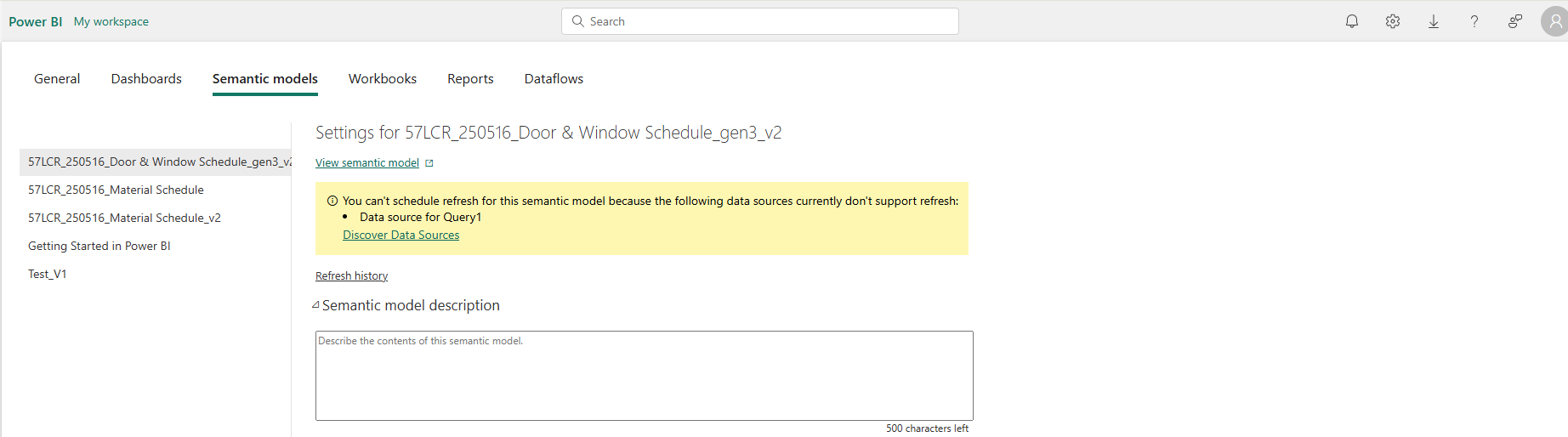

Hi, may I check if there is way to enable auto-refresh of the data query in Power BI?

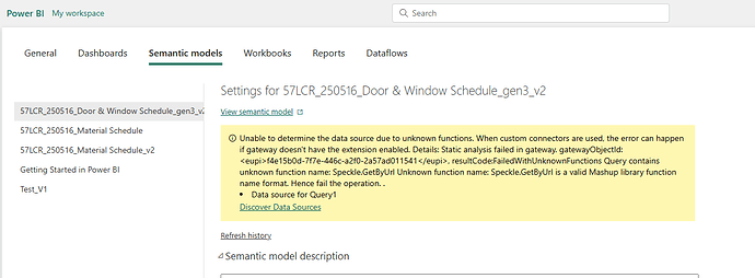

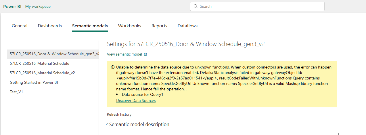

I have tried scheduling refresh on the Power BI but there is currently this error:
This feature would be helpful since we do not have to always open up Power BI to ensure the data is always updated (as per the versions in Speckle)

Hey @type0user1 ,

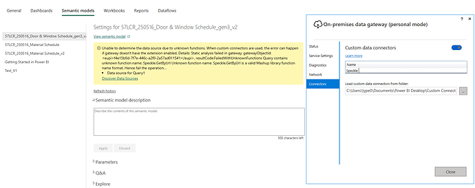

Have you installed Data Gateway for Power BI and made sure Speckle connector is in the location that Data Gateway is looking to?
I can’t seem to reproduce your issue.

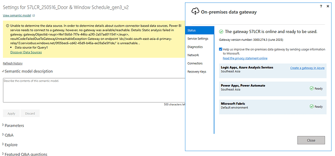

Hi @gokermu,

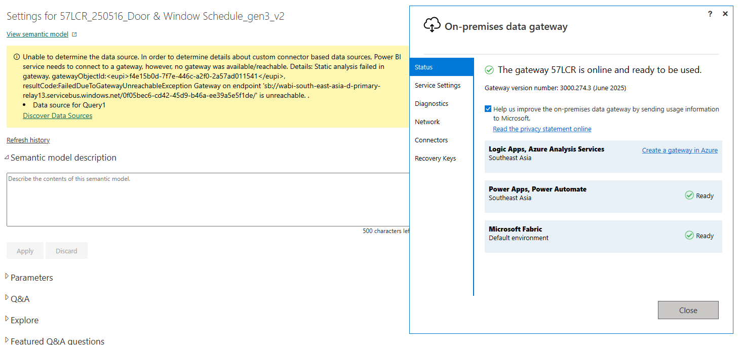

I am actually not quite sure what I am supposed to do using the Data Gateway for Power BI. Do you mind going through the few steps I need to take?
I have installed and set up the Data Gateway for Power BI and also made sure the Speckle Connector is in the location its looking to but it still does not seem to be working.
Same results for the Data Gateway (Standard Mode).

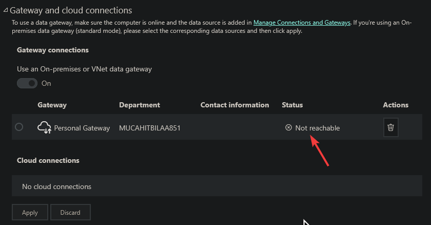

First, let’s verify the data gateway is working properly:
  1. Navigate to your semantic model in the Power BI web app
  2. Check the data gateway status
  3. If the status shows “not reachable,” this indicates a gateway connectivity issue (not Speckle-specific) → Refer to Microsoft’s documentation for gateway troubleshooting: Troubleshoot gateways - Power BI | Microsoft Learn

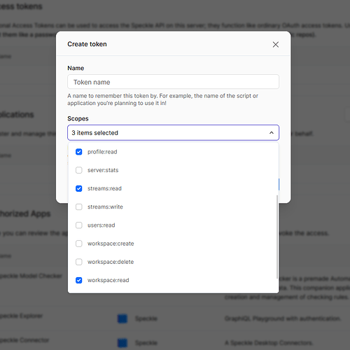

Since our Power BI connector currently doesn’t support OAuth2 authentication with data gateway refresh, you’ll need to use token authentication instead:
  1. In your semantic model, go to Data source credentials
  2. Switch the authentication method to Key
  3. Go to Speckle web app > Profile > Settings > Developer
  4. Create a new token with these required scopes:
Note: Additional scopes may be required depending on your specific data needs. If you encounter permissions errors, you may need to add streams:write or other relevant scopes.
Treat your API tokens like passwords - never share them publicly
  1. Copy the generated token
  2. Paste it into the Key field in the Power BI data source credentials
  3. Complete the authentication process
Your scheduled refreshes should now work properly.

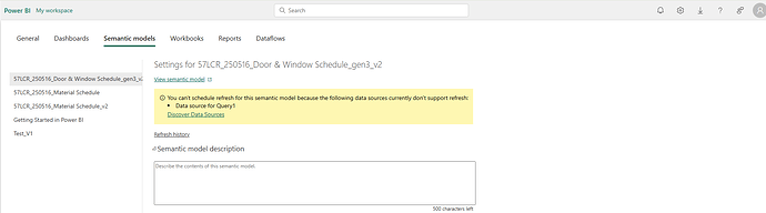

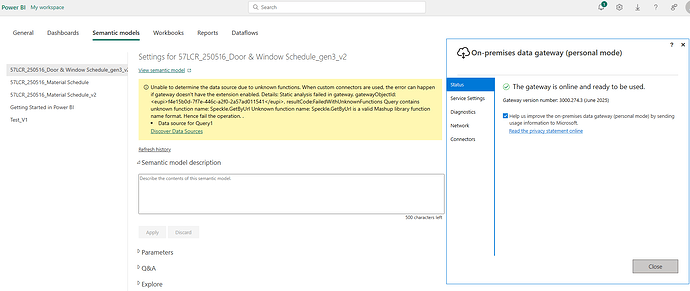

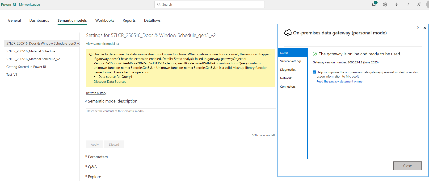

Hi @gokermu,
I can’t seem to even access the ‘Gateway and cloud connections’ tab in the first place. May I clarify what 's going on here? Thank you!
