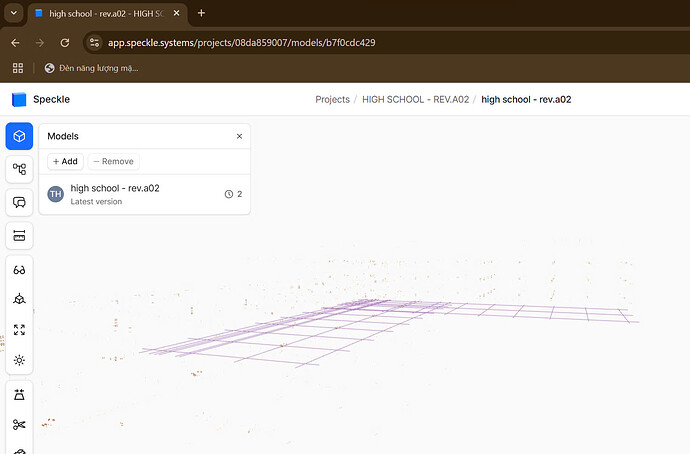

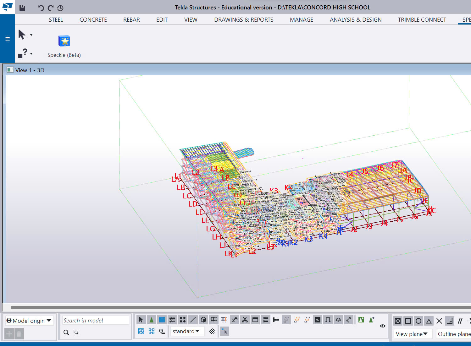

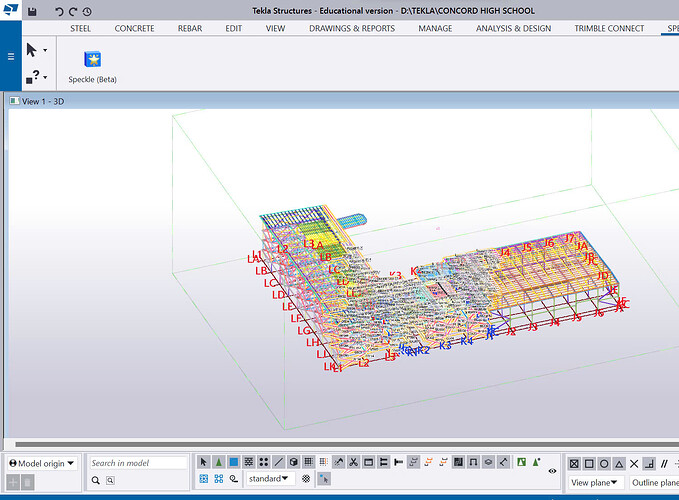

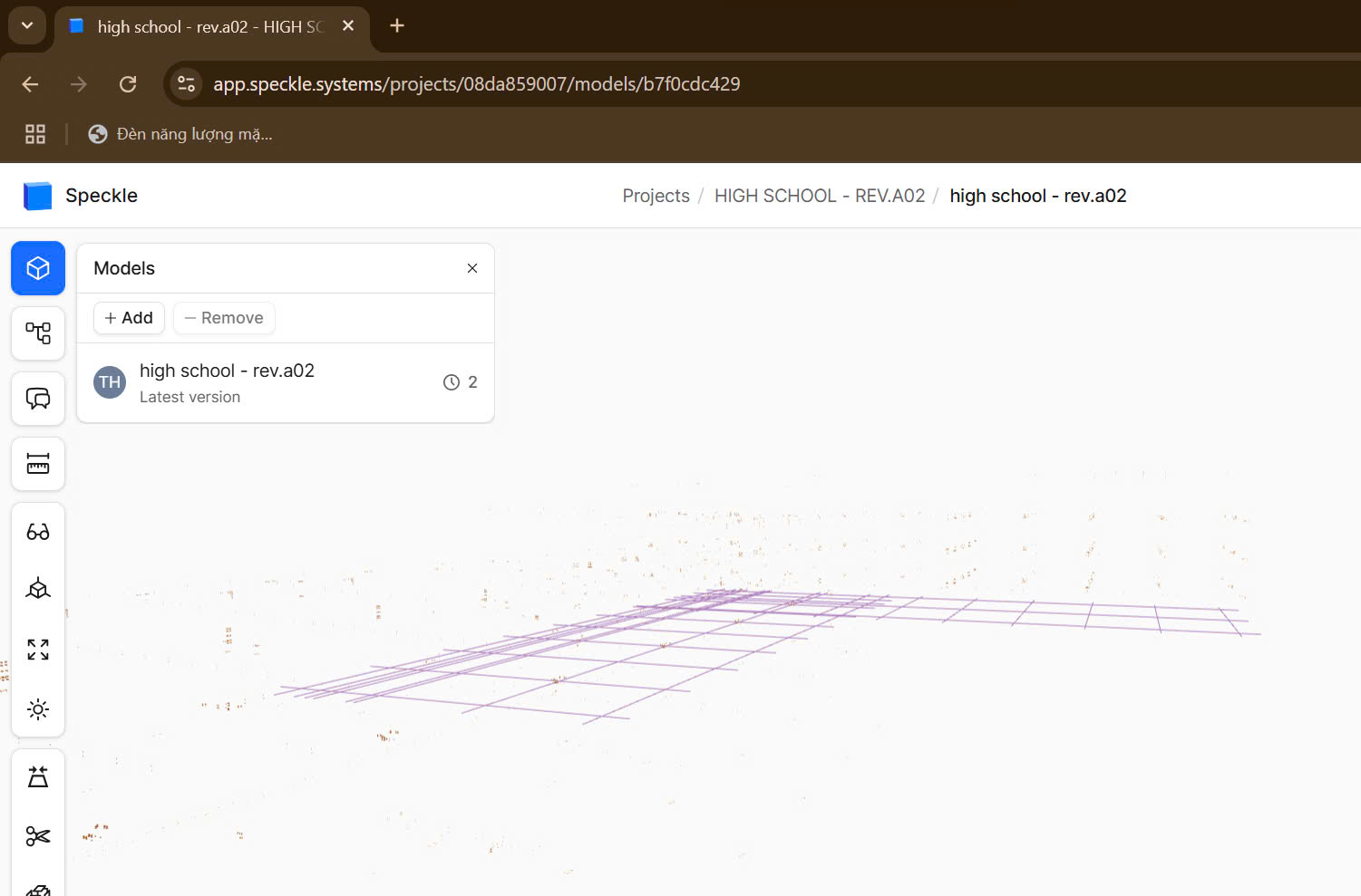

Hello All,
I have already published the assembly structure from Tekla, but I don’t see any assembly structure in Speckle. I only see the bolts and grid. Could this be because Speckle does not support assembly structures?
Hey @Trung535,
A quick off the bat answer - no, we currently don’t support assembly structures. Things are always under development and this is something we can consider for the future if it’s a big need on your end? If so, would you also be open to sharing the model with us for testing purposes? (I can send you a private link to a drive to upload it there).
