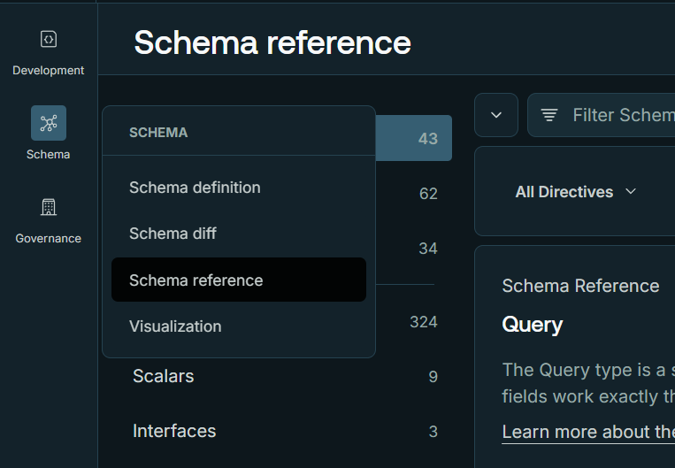

I’ll raise the out-of-date docs with the team.
In the mean time, I recommend checking out the GraphQL schema reference
here: Apollo Server
Any subscription that’s marked as “deprecated” should be avoided.
I’m also here if need any support, just let me know if you have any questions.
