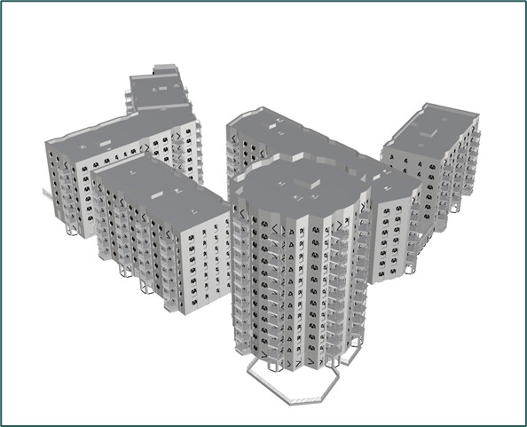

I upload a revit model (or series of models) to Speckle, and load them into rhino. they all locate perfectly relative to each other, like this:

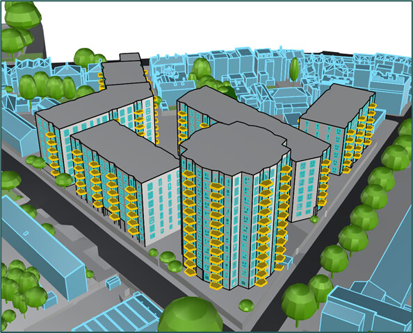

Next I want to add context meshes from Cityweft in rhino. There’s various ways to do this but I would generally draw the outline of the region as a rectangle which also loads this into my model. However, this is not aligned to my revit model collection, so I need to manually reposition and rotate the context until it aligns and I end up with something like this:
Now this manual step isn’t particularly difficult, but I have broader ambitions of running this process headlessly in the background, therefore if I could automate this I might get there.
