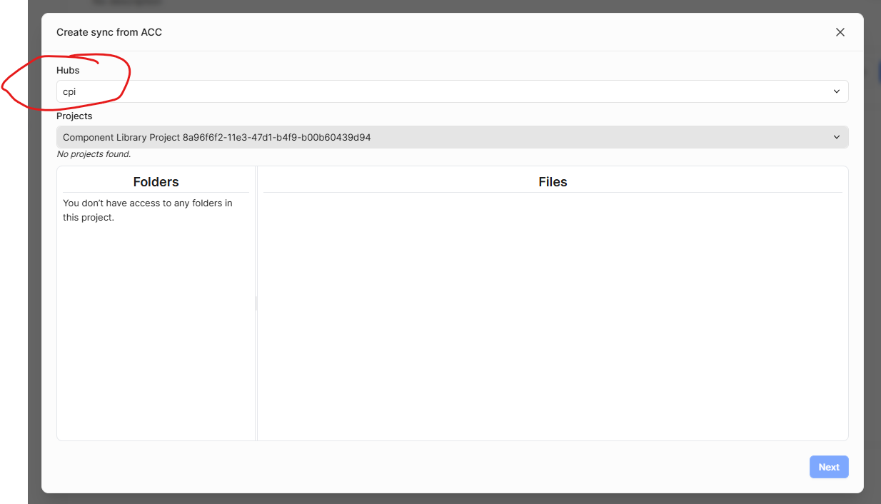

Can I have projects from multiple different contractors who are hosting. It appears I can only access models that are on my Hub.
How do I access all the models that I see in my ACC account?

Hi @dandepoe,
The account owners must add Speckle as custom integration to be able see those models too. This is not a limitation on our side its how integrations work on ACC. I suggest you contact with the account admins on other hubs to complete that step for you.
