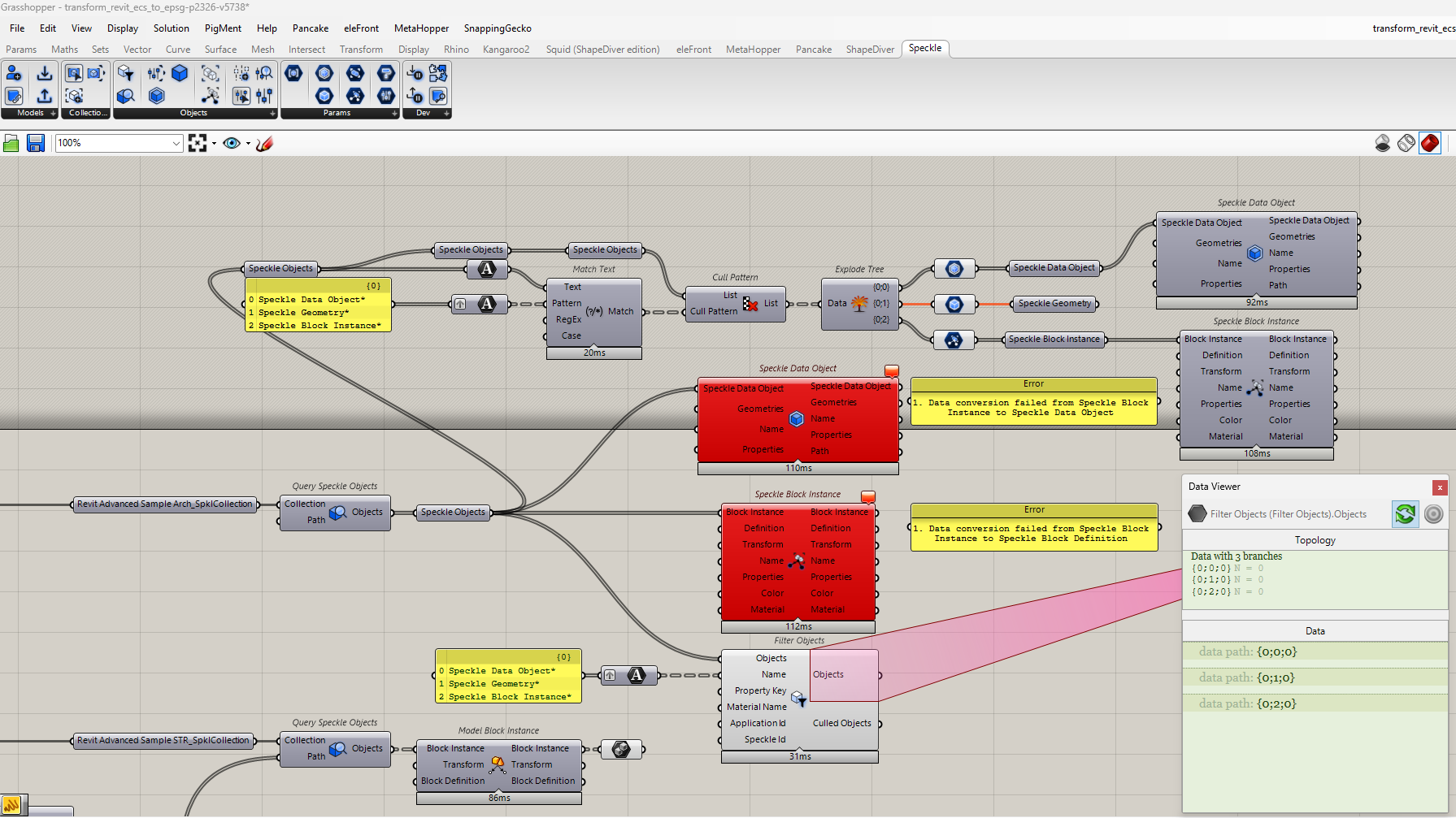

I’m transforming (“georeferencing”) the architectural and structural Revit sample models into my Kai Tak, Hong Kong project:
What I’m struggling with is how I should deconstruct the different types of Speckle Objects that come out of the Query Speckle Objects component when there are multiple types of Speckle Objects (Speckle Data Object, Speckle Block Instance) in that collection:
I did find a work around as you can see in the image, but I thought there must be a smarter way of doing that?
Maybe with the Filter Objects component?
