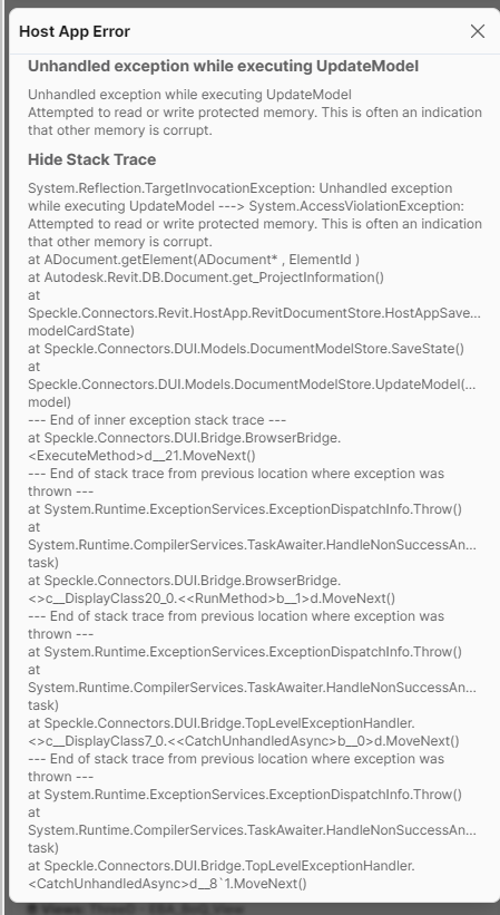

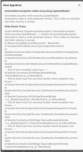

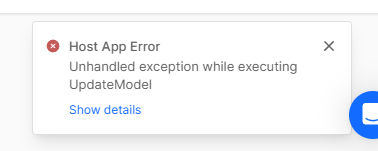

Hello, I noticed this issue using Revit 2024.3 and latest Speckle Connector for Revit 3.9.0.
Even renaming a view takes a long time, and then I got the following error
Details:
I have since disabled the addin and Revit got back to normal.

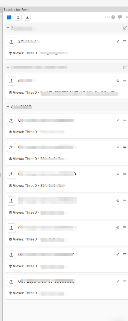

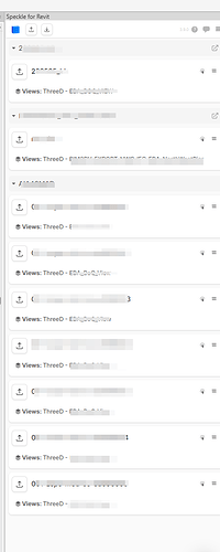

Additionally, is it normal behavior to see all my latest projects uploaded to Speckle on the sidebar?
I remember in previous versions, only a Speckle model related to the specific Revit model was shown.
Many, if not all of them, are reporting they are out of date with the application, although I never connected the Revit model to those streams.
Is it trying to evaluate whether all of the streams are out of date?
It gets too cluttered and easy to make mistakes when all streams are available.

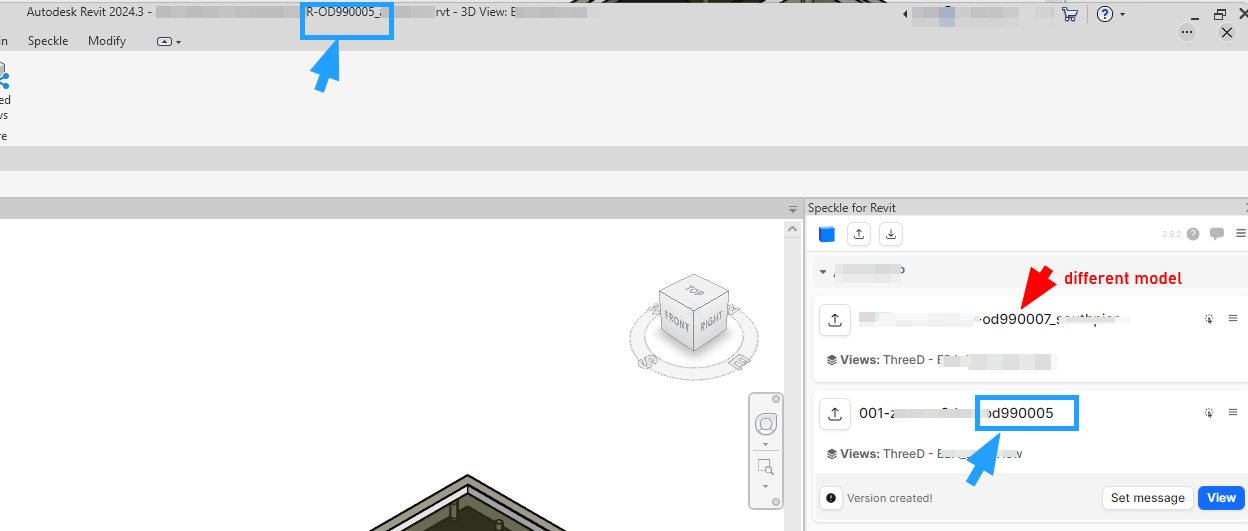

hello, I just did, I think the slowness is gone, but I can still see irrelevant models in the model card.

Tried the steps and I still get persistent models appearing in the Speckle pane. Is it maybe because they all belong to the same Speckle project?
Basically I am uploading a bunch of models to federate them in Speckle.
They all are linked within each other, various disciplines, various building parts.
It is not very important, but I would like to understand whether it is expected behavior or some kind of bug!
