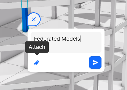

The only way I have seen this being done to date is to make a federation of all the uploads from a version of Revit, and then make a comment and upload the revit file at that point as an attachment.

Your question was about storing files and this is currently only possible by the comment attachment I mentioned.
