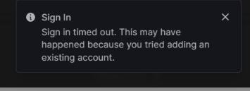

The frontend opens and works but the Revit connector does not connect to the frontend. Here is what happens:
  1. I add a new account using the ec2 ip and press sign in in Revit
  2. I then get redirected in web to a page which asks to authorize the application
  3. Then it immediately redirects to a page saying that the application has been authorized
  4. After that in Revit the sign it just times out
