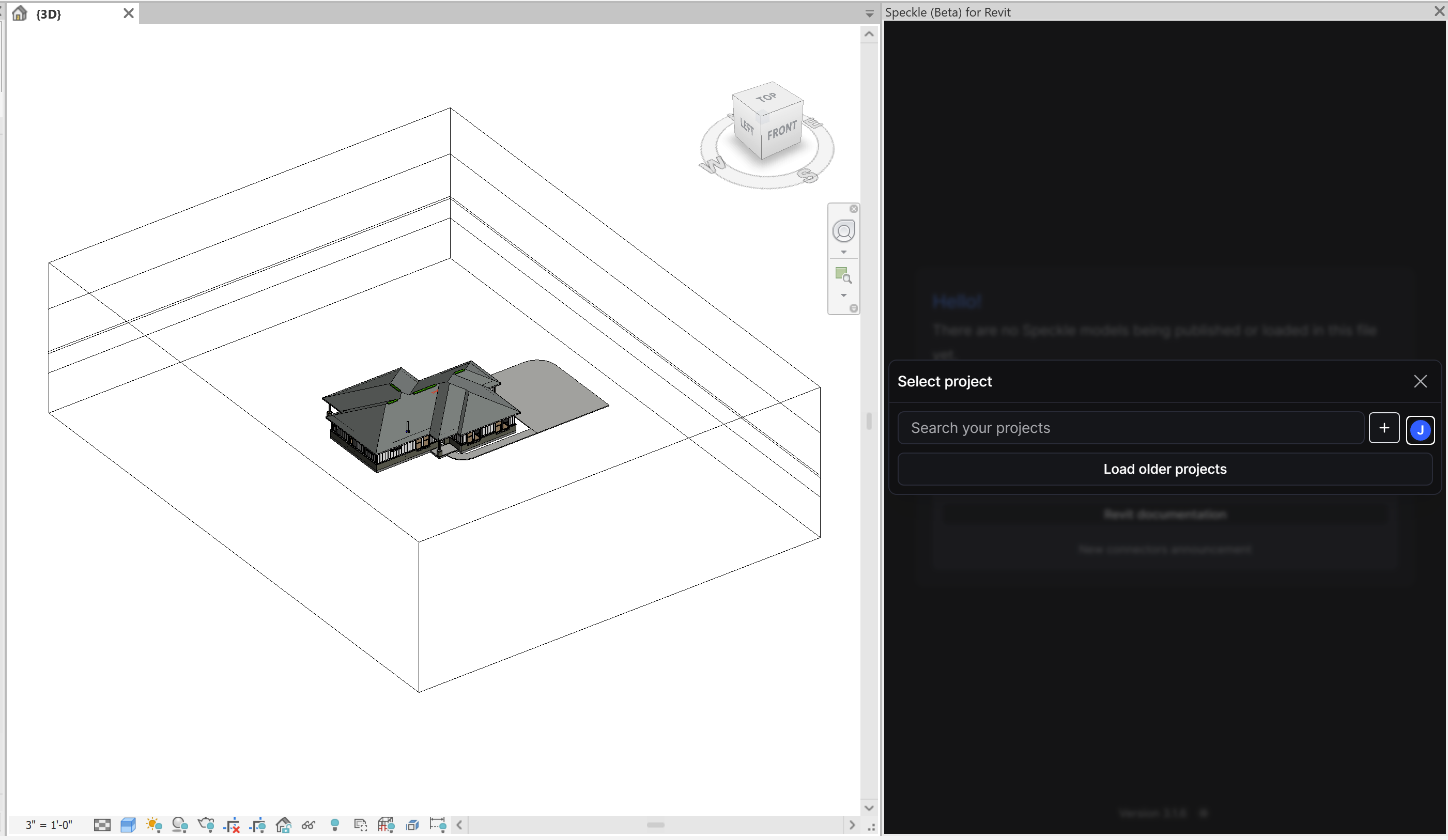

I deployed Speckle Community Edition successfully internally. So to take it out for a spin I created a project and downloaded the Revit Connector. The Connector authenticates with the server just fine but then when I click Publish it opens the Select Project box but no project can be selected… the blue progress bar shows up but nothing, same if I click Load Older Projects.

Oh sorry… nope only one speckle account on that machine. I can only upload one screenshot because my account is new. So in that screenshot: There are no projects to select, loading older projects give you a quick progress bar but nothing loads, creating a problem also fails: it basically let me type a name for the project but the button is disabled
