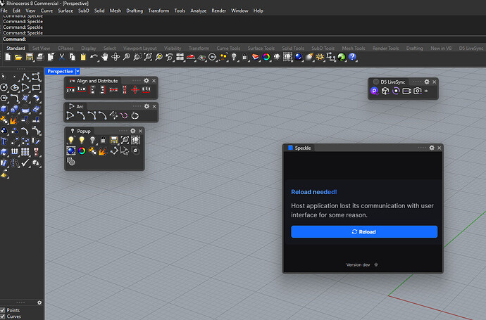

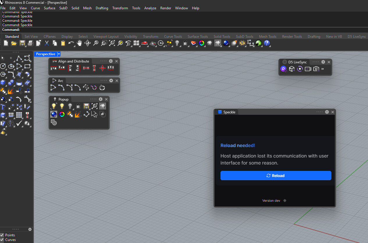

Hi everyone, I’m having this error and don’t know how to solve it. Please help me with the solution. Thank you very much. My English is not very good.

But as I see, your Rhino looks like running in English.

The only issue i can see is possibly conflicts with other plugins. Can you try turning them on/off?
Eg, in your earlier screenshot I saw D5 LiveSync in there too - not sure which one of them could be the culprit, but it’s an option.

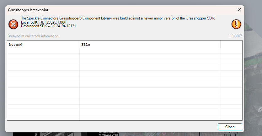

This is the notification code
This is likely the problem.

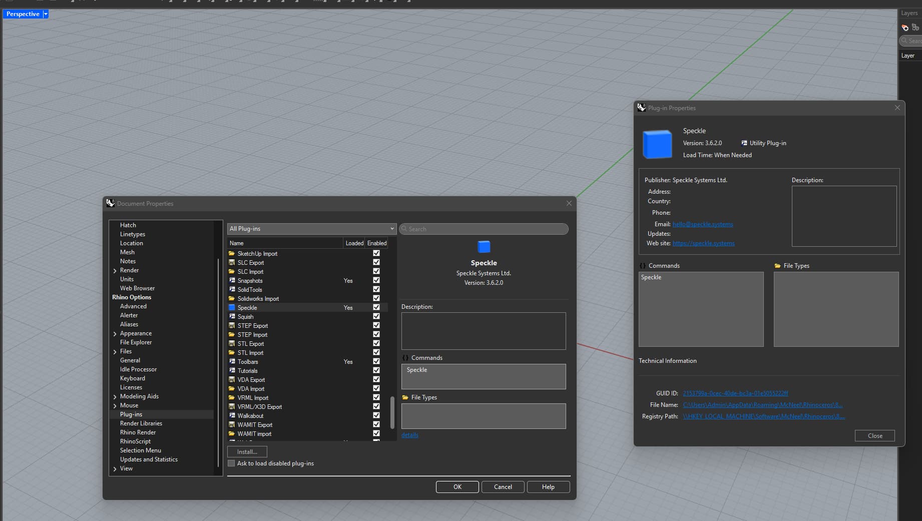

The minimum version of Rhino8 our plugin will load with is 8.9 as you see in your screenshot.
So I recommend updating to something newer.
