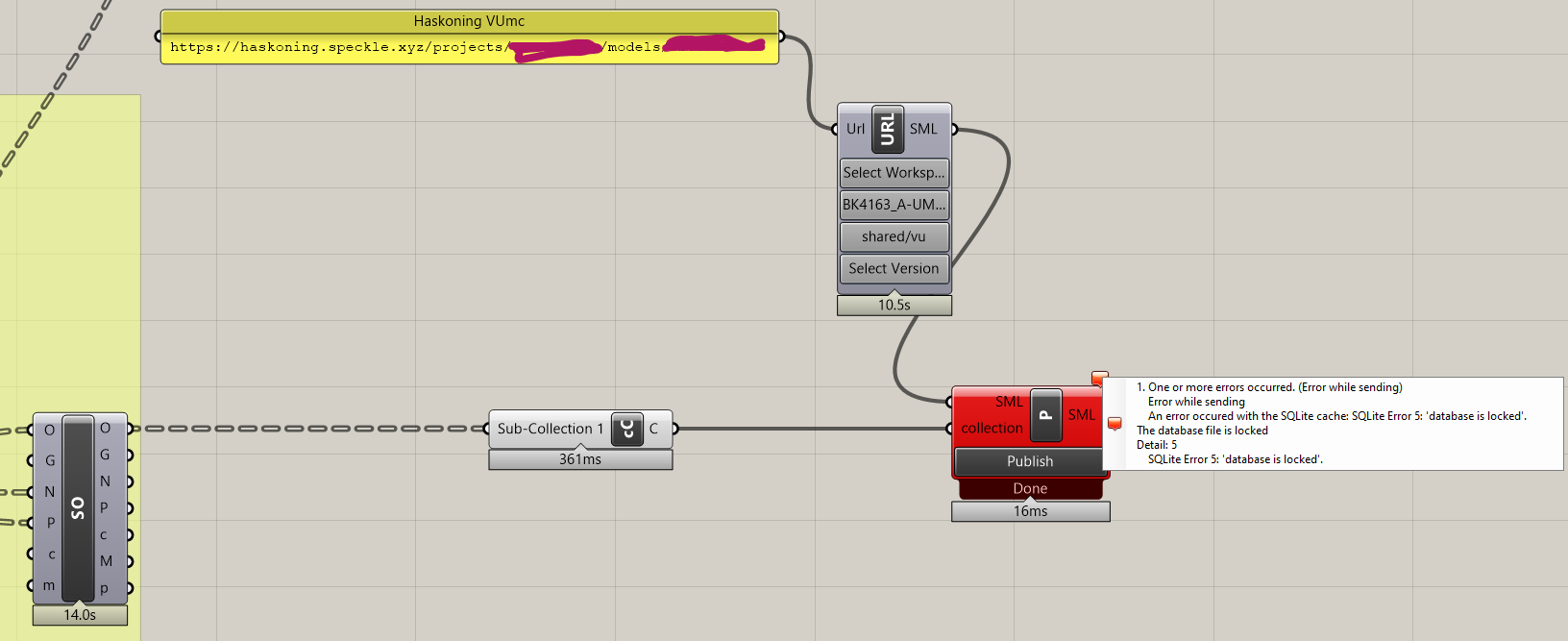

Publishing to Speckle crashs at the very end v 3.3.3
I have an issue with publishing into Speckle.
The ppublishing component sometimes crashes at the very end of the process.
the process goes fine but at the end I have a message that the “database is locked”. See image below.
Any help here?
@clrkng , @Nikos . Any ideas?
Sorry, I think I am getting all the bugs of the newest release
@adamhathcock has seen this error in Revit before, it may do with a very large number of SQLite write requests - probably happens when you’re pushing a huge large model.
He’s looking into it, but in the meantime it’s probably best to split this up into smaller models if possible
Hi @clrkng and @adamhathcock thank you for your reply. I have seen this error a few times again with different models but after trying a couple of times (maybe restarting Rhino) it works again. Unfortunately, not in this case. I can’t push thinks to speckle yet and I can’t split the model either.
I’ll appreciate some quick help, my hands are tied without the possibility to publish. Thanks!

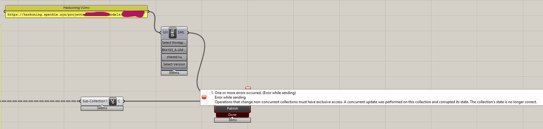

As an update, today I got this new error
@adamhathcock I will join the call you sent now
