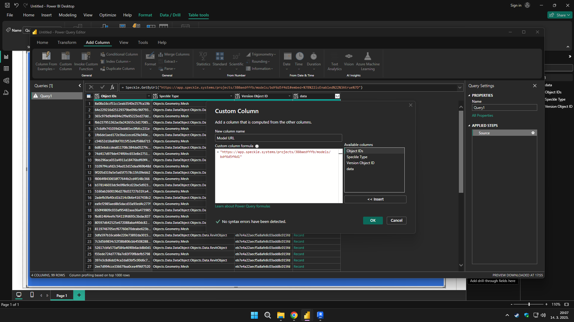

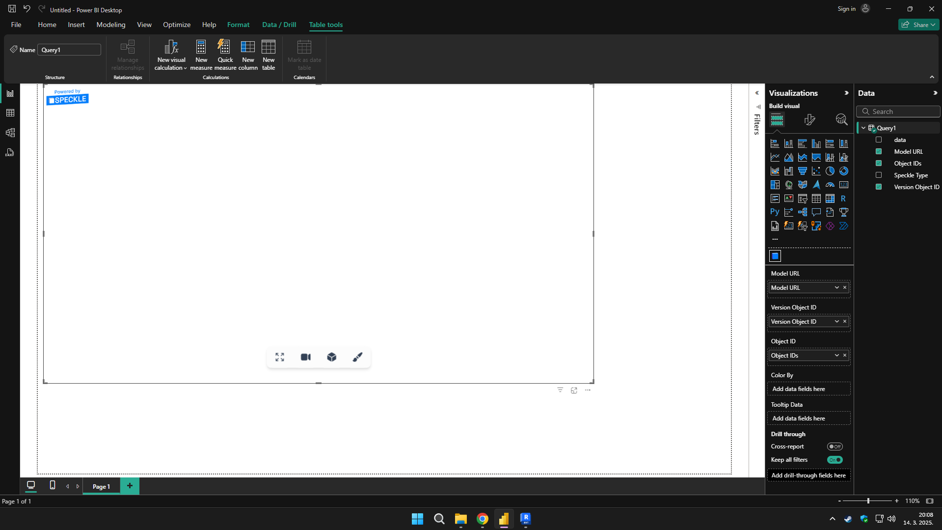

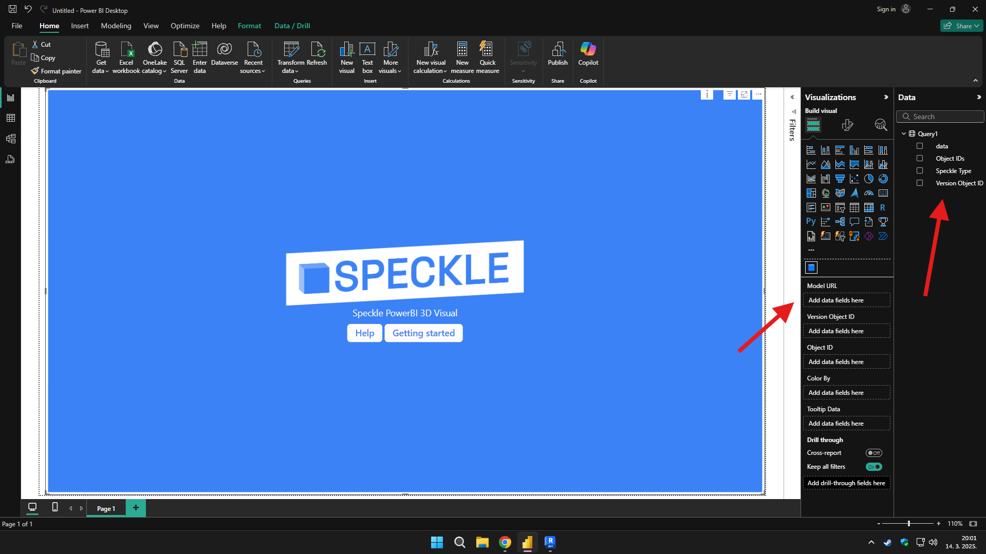

I’m noticing that the ‘Stream URL’ category is not automatically created in Power BI, which is required for showing the 3D model.
I tried to edit the query and manually add a column with the URL, but it doesn’t work. I can’t see the 3D model.
Also my link is shareable and I did everything else according to tutorial.
I’m using latest version of PowerBiSpeckleVisual 2.19.0
Thanks in advance!

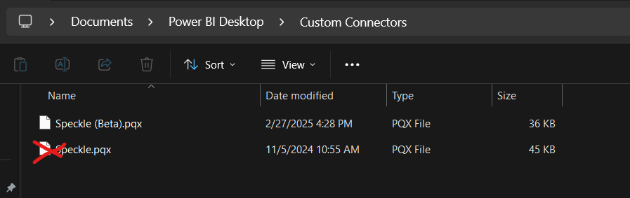

hey @naazuky
I think you are mixing up the NextGen Connector with the V2 legacy connector(that you probably installed in the past at some point), this is our fult - we should have communicate better that you need to uninstall the old connector first.
Please follow the steps:
First close PowerBI, go to the Documents > Power BI Desktop > Custom Visual
and make sure you only have one file here Speckle (Beta) Power BI 3D Visual
. If you have two delete the other one.
Then do the same with Documents > Power BI Desktop > Custom Connectors
Now if you open PowerBI and follow the same steps, you should only see the NextGen connector and 3D viewer.
Let us know if you still have issues.
