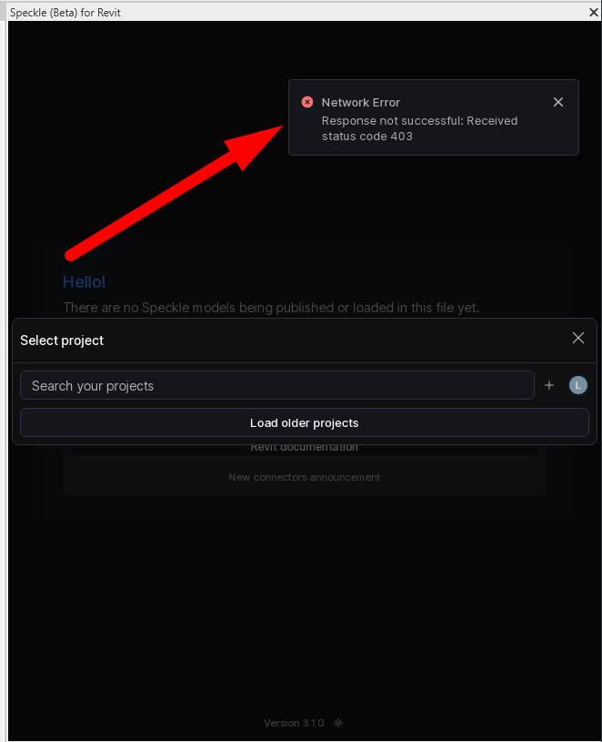

When I try to upload a Revit model to Speckle, the plugin shows me the following error: Network Error_code 403. And I can’t load my projects in Speckle.
Currently, I am using the Revit connector V3_3.1.0.
Everything was working well until recently. The only change I made to my computer was updating to the latest Autodesk Desktop Connector.
If anyone has faced this error before, I would appreciate your help in fixing it.
Regards,
Lázaro
Hi @Lazaro_Orestes_Brito,
It is hard to say whats going on, but looks like it is an auth issue. What I would suggest to you to remove account and sign in again. Let me know if it helps or not.
Best
Hello @oguzhan, I remove my account and I singned againg and work whothout problem. Thanks!!
