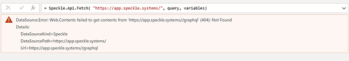

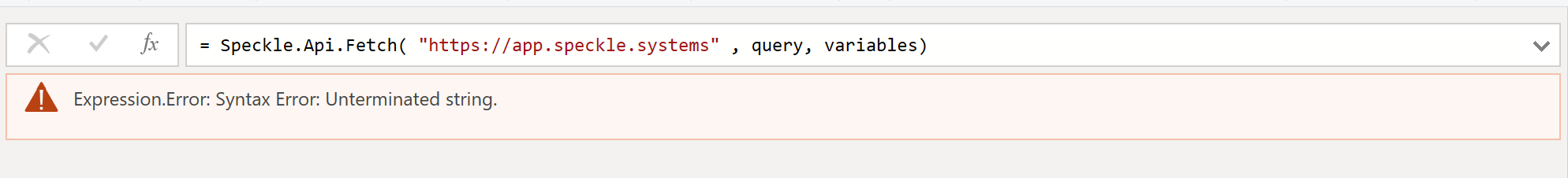

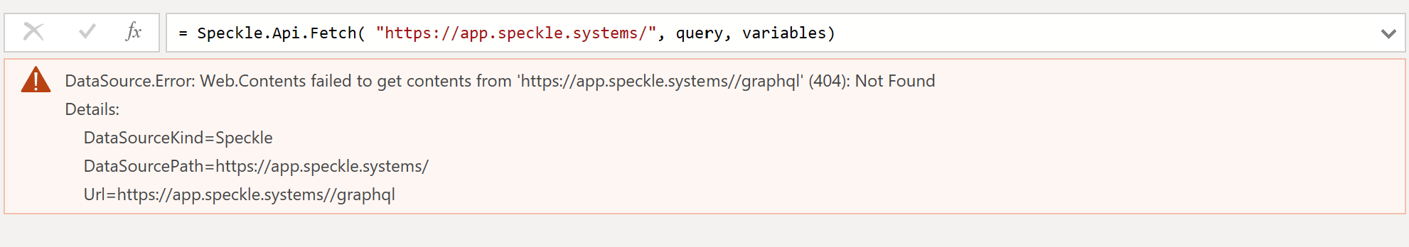

I didn’t get the exact code to work in power query. On replacing the “SERVER_URL” with the speckle server I get the below error.
I then add an additional / and get a different error.
Any idea what’s going on here - or have I got the complete wrong end of the stick?
Looks for sure like it is sensitive to trailing /. For the prior error id double check the values of query and variables
