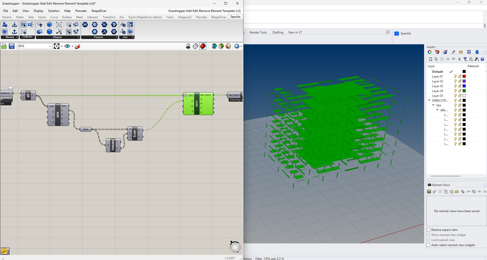

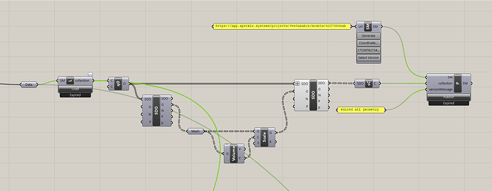

Hi Björn, I apologize for the late response. From what I can tell I’m taking the same steps you are and with the same components, but here is the rest of the relevant part of the script:

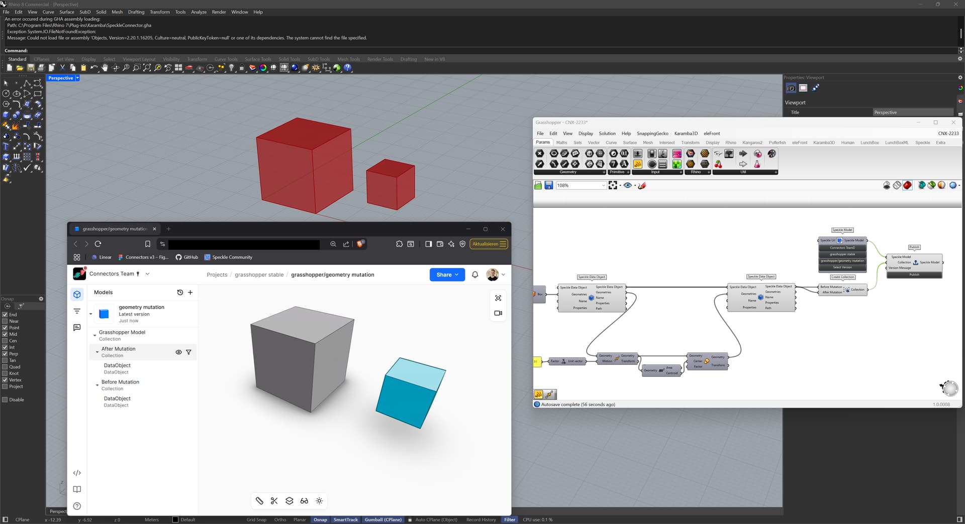

I haven’t been able to reproduce this - the changes are reflecting as intended. Maybe to take a step back for me to get the whole picture, are you receiving a model from a Speckle project, mutating the mesh and trying to send the modified geometry back to the original model? What happens if you publish to a different or new Speckle model in your project?

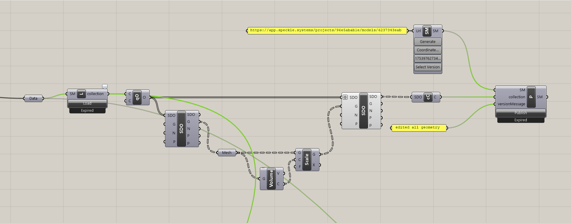

Hi @bjoern, I did try that as well but without success. I’ve attached
Grasshopper Add-Edit-Remove Element Template (v3) - Simplified.gh (13.1 KB) if that helps – I may be configuring things incorrectly somewhere else in the setup. Can you spot any issues or reproduce on your end?

Thanks for the patience on this. We were able to reproduce; the issue was only only load → edit → publish workflows. v3.8.2 which we’ve just released includes a fix for this. You can now mutate geometries of your SpeckleDataObject as expected :partying_spockle:
