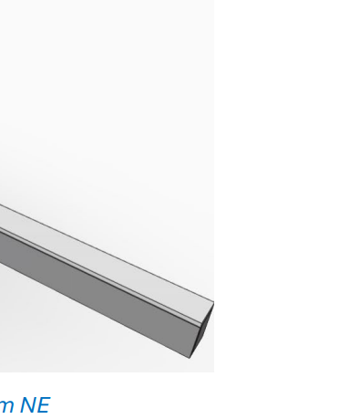

In our workflow, we often export geometry snippets from the web viewer to include in technical reports. However, we’ve noticed that the viewer background is slightly tinted, which can be visually distracting when embedding these snippets into documents. For clarity and aesthetics, especially in reports, it would be extremely helpful to have the option to render the viewer background as completely white.
This would allow the geometry to “float” seamlessly within the text, without any visible background tint interfering with the layout or contrast.
Is there currently a way to achieve this, or could this be considered as a feature enhancement?
EX:
Thanks in advance!

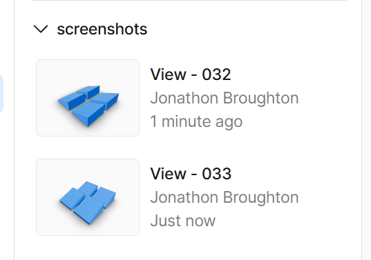

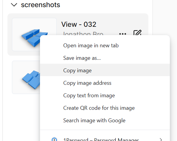

Depending on the resolution you are seeking, you can already get a transparent background version of a view from the saved views feature
Each of those thumbnails is available as a static image, and it is also a good record of what you are exporting if you group them
This isn’t particularly high resolution. BUT it is available today.
