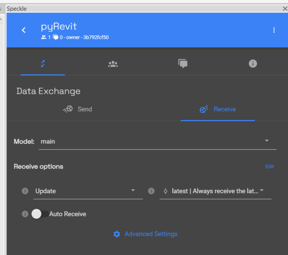

I have a custom view in Revit where only parts are visible. Now i select all my Parts an send the stream to speckle. In Speckle everything seems to be fine.
Then i was interested in what is happening, if I receive the same stream into my Revit File. Unfortunatelly now all my parts are duplicated in Revit, even though I had the receive-options set to “Update”.
Is there a general Problem to update parts, or do i make a mistake?
