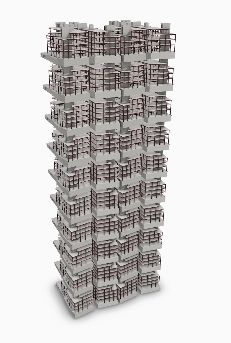

I am having trouble to load large files in the web browser viewer, here it goes one test model
https://app.speckle.systems/projects/e2a7b596f2/models/ddaf8349f5

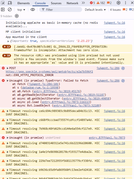

Can you please provide us with the console output?
Cheers
Hi @alex please see the console output below:
@teocomi I have tried both in Edge and Chrome. Hardware is a high spec CAD laptop.

The example model is about 2.3Gb in size in total. The viewer has a built-in timeout of 3 minutes, so if any part of the connection between your computer and Speckle isn’t fast enough it will struggle to complete downloading the required data within that timeout.
The good news is that the partial download of data is stored locally in your browser, so if you press refresh on your browser it will resume downloading from where it left off. This should enable it to eventually succeed.

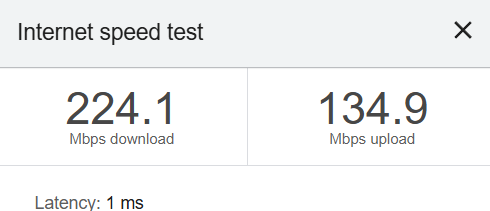

It seems to load at different percentages every time which turns out a bit frustrating. Never got past 49%, the internet here seems to be fast enough for anything at 250Mbps download. While trying to search elsewhere it is likely there is something throttling like VPN of firewall. Is there a speckle address I could ask IT to whitelist and test again?
Thanks,
