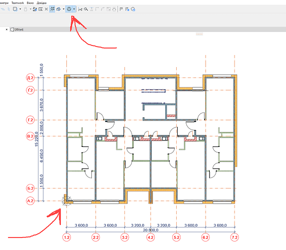

Hello, everyone!
Is there any option in Speckle to see the real coordinates of each file when comparing models with Survey Point?

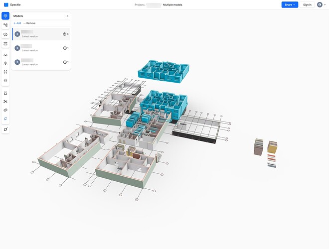

Hey @_Sergii_Holomah,
When publishing your model from Archicad, you have the option to set the origin from the choices provided. You can view all the origin points if you place a point or geometry there. Please note that we do not publish multiple origins from Archicad.
Hey @gokermu
I published my model not through IFC (where all Survey Point-related options are indeed available) but directly using the Speckle connector. Maybe I am missing some additional settings. If so, could you provide documentation or a screenshot illustrating what you mean?
Also, could you clarify what exactly you mean by “we do not publish multiple origins from Archicad”?
I am sorry @_Sergii_Holomah,
I wanted to clarify that while our Revit connector has the functionality you’re looking for, it seems our Archicad connector doesn’t quite have it yet. We’re definitely keeping this in mind for our next-gen Archicad connector, though!
Speckle has it’s own origin. While publishing a model, we accept the internal origin of the host application as the origin.
